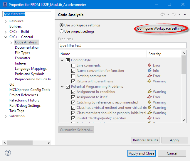

Dear community,
I am using MCUxpresso 10.3.1 (2233), and I would like to use the integrated code analysis. However, I must be missing something as it's never doing anything. I am using the project explorer window to right-click on a source file (e.g. main.c) and choosing "Run C/C++ Code Analysis" from the popup menu. Then nothing happens. Can somebody tell me what I'm missing?
thx in advance
  Martin

Hi Martin,
Check if you have enabled Code Analysis (see Free Static Code Analysis with Eclipse | MCU on Eclipse ).
Check the properties of your project: usually it uses a workspace setting:
In that setting, enable the items you want to have checked.
I hope this helps,
Erich

Hi Erich,
thanks - that helped! I didn't realize I had to first enable code analysis settings.
(I would have expected the code analysis menu command to at least display a warning/tip that I should enable it somewhere)
