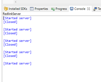

A month ago MCUXpresso stopped being able to launch debug sessions, it now gets stuck at "Target Discovery":
After a while I get this error message:
Redlink server console:
I am using MCUXpresso IDE v11.4.1 [Build 6260] [2021-09-15] with a LPC-Link2 debugger.
I have tried reinstalling MCUXpresso and re-flashing the debug probe but the problem keeps happening. Note that this problem happens regardless if I have any debug probe connected to the PC or not.

How about delete the folder of .metadata under MCUXpresso IDE workspace, then use a simple project to debug.

Check your firewall and/or AV software. It looks like the IDE is being blocked from communicating with the debugger.

Sorry I forgot to mention that I disabled both the AV software and firewall, which already had exclusions set or MCUXpresso and redlinkserv. I used to be able to debug without issues just with the exclusions.

I have deleted the .metadata folder, re-added my .launch file and the debug session started normally.
Thank you!
