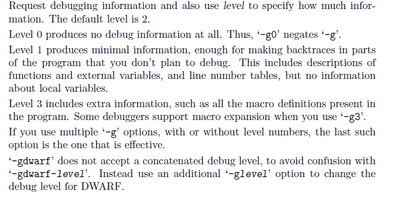

4,274 Views
ZhangJennie
In "Release", we suggest setting debug level as Default (-g). Here is description about debug level
Hope this helps,
Jun Zhang
