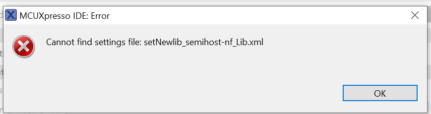

Want to try USB vcom example on Freedom K64F board.
Import project with newlib_semihost produced this error:
MCUXpresso_BUG_import_USB_VCOM_newlib.PNGWhat's going on?
The import continued, and build produced this further error:
c:/nxp/mcuxpressoide_11.1.1_3241/ide/plugins/com.nxp.mcuxpresso.tools.win32_11.1.0.202001081728/tools/bin/../lib/gcc/arm-none-eabi/8.3.1/../../../../arm-none-eabi/bin/ld.exe: c:/nxp/mcuxpressoide_11.1.1_3241/ide/plugins/com.nxp.mcuxpresso.tools.win32_11.1.0.202001081728/tools/bin/../lib/gcc/arm-none-eabi/8.3.1/../../../../arm-none-eabi/lib/thumb/v7e-m+fp/hard\libcr_newlib_semihost.a(syscalls.o): in function `_read':
syscalls.c:(.text._read+0x0): multiple definition of `_read'; ./source/retarget_itm.o:C:\Users\developer\Documents\MCUXpressoIDE_11.1.1_3241\workspace\frdmk64f_dev_cdc_vcom_freertos\Debug/../source/retarget_itm.c:146: first defined here
c:/nxp/mcuxpressoide_11.1.1_3241/ide/plugins/com.nxp.mcuxpresso.tools.win32_11.1.0.202001081728/tools/bin/../lib/gcc/arm-none-eabi/8.3.1/../../../../arm-none-eabi/bin/ld.exe: c:/nxp/mcuxpressoide_11.1.1_3241/ide/plugins/com.nxp.mcuxpresso.tools.win32_11.1.0.202001081728/tools/bin/../lib/gcc/arm-none-eabi/8.3.1/../../../../arm-none-eabi/lib/thumb/v7e-m+fp/hard\libcr_newlib_semihost.a(syscalls.o): in function `_write':
syscalls.c:(.text._write+0x0): multiple definition of `_write'; ./source/retarget_itm.o:C:\Users\developer\Documents\MCUXpressoIDE_11.1.1_3241\workspace\frdmk64f_dev_cdc_vcom_freertos\Debug/../source/retarget_itm.c:78: first defined here
What's going on?

This particular problem was fixed in the recently announced v11.2.0 release.

[email protected]‌ - I am using 11.1.1 with SDK 2.7 on Windows 10.
Simply import the example like this:
1) Choose Freedom K64F no-bluetooth
2) Choose USB CDC VCOM FreeRTOS example
3) Specify newlib (not nano) with semihosting
You will see failure above.

I appreciate  your patience and additional details. I have not managed to replicate the issue  on my side.
To narrow down the problem, Can I suggest you reinstall the IDE and  import the example again?
Additional details, Altougth I got the  same IDE Error when creating the project, the build succeded
Please let me know your results,
Kind regards, Diego

I  tried to replicate your issue without success  using MCUXpresso v11.1.1 and FRMD-K64F SDK  v2.7 and v2.6
Please, help  me importing the same SDK example  on a different path like   c:/projects/ and let me know your results.
