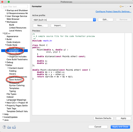

Each time I save the file startup_mke02z4.c from the MCUxpresso IDE this part of the code:
  __attribute__((used, section(".FlashConfig"))) const struct
    unsigned int word1;
    unsigned int word2;
    unsigned int word3;
    unsigned int word4;
  } Flash_Config = { 0xFFFFFFFF, 0xFFFFFFFF, 0xFFFFFFFF, 0xFFFEFFFF };
is surreptitiously changed to:
const struct
    unsigned int word1;
    unsigned int word2;
    unsigned int word3;
    unsigned int word4;
  } Flash_Config =
I don't care too much about the formatting, but the second form results in:
- "warning: 'used' attribute does not apply to types [-Wattributes]"
- "warning: 'section' attribute does not apply to types [-Wattributes]"
- "arm-none-eabi/bin/ld.exe: Linker Flash Config Support Enabled, but no .FlashConfig section provided within application"
- "error: ld returned 1 exit status"
All that for a change I didn't ask for nor I want.
To make any change I must always modify, and save, that file with an external editor.
Why does MCUxpresso IDE behave so?

Of course "formatter" was the first place I looked into, but the formatting must be requested.
And in "Save actions", "Format source code" is unchecked.
What I overlooked was "Align const", that was checked.
Thank you

I don't see this behaviour - no reformatting of that block in code I'm looking at now.
You should check the "Formatter" and "Save Actions" settings in your workspace Preferences.
