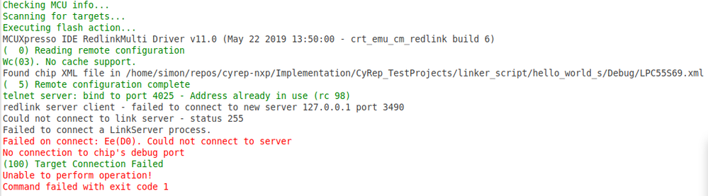

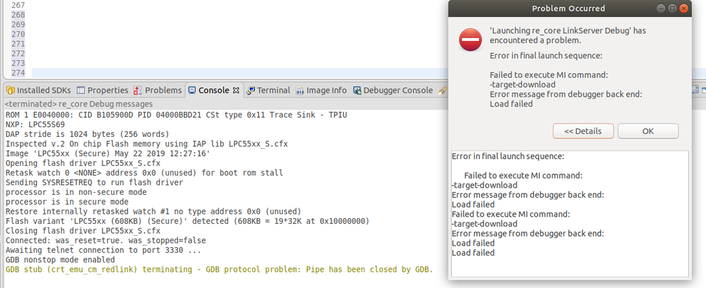

simon_ott
I attached two screenshots. Sometimes the erase via the GUI flash programming tool fails and sometimes I am not able to debug. It happens sporadically and randomly, after 2-3 tries it works again.
As it happens not too often, it's okay, I just would be interested how it can be caused, as in the blog post I linked it is stated that you can "program an image into flash that when run prevents further debug operations succeeding", but is not stated how the image must look like in order to cause this behaviour. screen1.pngscreen2.png

ZhangJennie
Hi Simon
Could you please post your error screenshots? Thanks.
