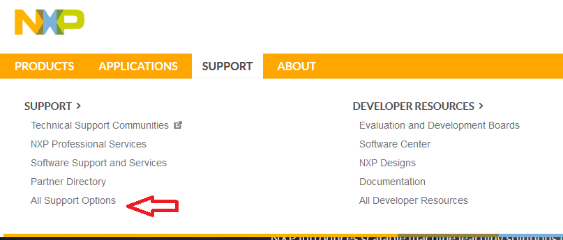

danielchen
Hi Brian
Please refer to below link to submit a request.
How to submit a new question for NXP Support
Please click the all support options
