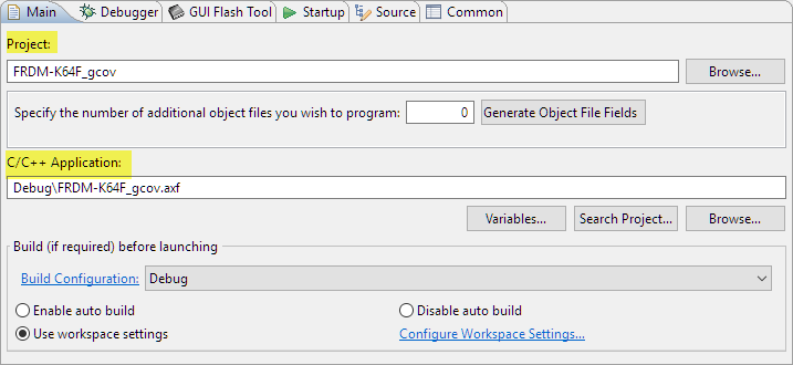

I have a problem to connect the MCUXpresso debugger to my KL46 Freedom board through the open SDA port. I use MCUXpresso 10.3. When I try to make a debug configuration I get always an error message (see picture in attachment). When I use the "Debug with PEMicro probes" button in the "Debug your project" windows, MCUXpresso don't found my board even I can see it mounted like a disk on my PC (I see it in the device manager too). When I go to another PC all is going well with the same board. I have re-install the PEMicro driver, I have re-install MCUXpresso and the same problem is still there... An idea?

Could you share a screenshot of your debugger launch configuration?
Check the project name and the C/C++ Application settings (marked below):
I think you have them somehow empty or wrong?
I hope this helps,
