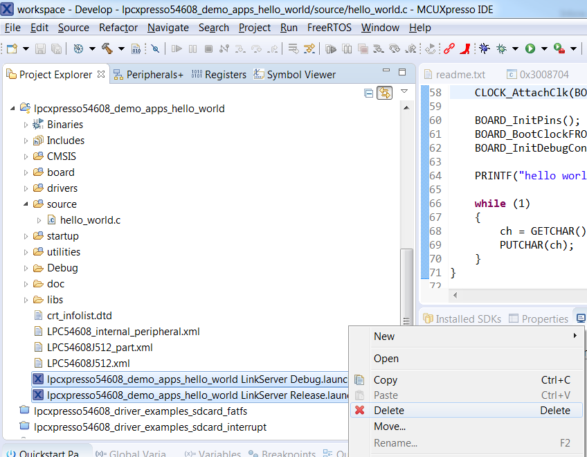

can someone tell me, how i choose the COM Port of the Board, that i want program/debug next. Unfortunately i cant find that config in the MCUXpressoIDE and getting tired of connect/unconnect the boards, if there are a lot of Boards in the Network, from USB-Ports. Thanks a lot!

Hi Steffen,
Which debug probe connection are you using (LinkServer, P&E, SEGGER)?
As a workaround, when moving from one board to another you could delete the current launch configuration files, this will force MCUXpresso IDE to perform a Debug Probe Discovery operation and present the list of debug probes found from which you can chose the new board.
Hope it helps!

Hello Carlos,
thanks for your response! Iam using the LinkServer debug probe connection. I already thought that this is the only way, but hoped for another easier :smileywink:. Thanks a lot!
