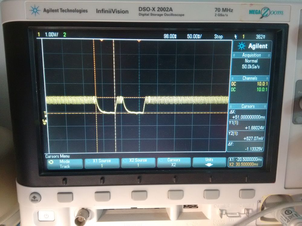

acharya_satishb
This is the reset pin capture when I debug a project and I get the error: cannot connect to core.
In contrast, this is the reset pin capture when I drag'n'drop a project into my board and the debugger makes better progress and can talk to the core but still fails.
Looks like there is some fundamental difference in reset behavior between the drag'n'drop scheme vs MCUXpressoIDE's debug scheme.
Any insight?
Satish
