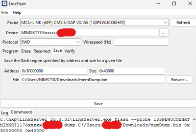

I have a problem with a Save command from LinkServer:
Below you will find a screen from LinkFlash GUI tool from where I can execute Save command (which performs memory dump into a specified .bin file) which works correctly:
However, if I perform the same command from terminal as in the Commands section on the bottom of the picture above, I get a following error (bottom part of the picture below):
I copy pasted the command from LinkFlash to the terminal, I also checked for some invisible characters that could be copied along the way. There were none, string was proper.
Any ideas?

Hi @mimlo ,
I did a test for your question,  I'm having the same problem as you.
Then I modify the save command as following, it works, Please try it.
I will also escalate your question internally.
Thanks for  raising  this issue.
Wish it helps you.

Hi @mayliu1,
Thanks for this, did not think about trying to revert the arguments.
That worked for me as well, thanks!
