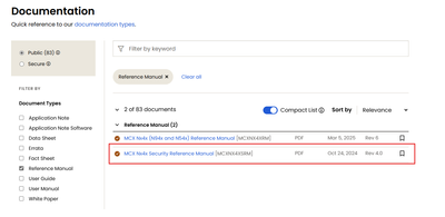

Pablo_Ramos
Hi @Kevin_Pang
In this case the x is the secure level you want to set the eDMA0.
For further information regarding the registers the definitions are modifying you can search it on MCX Nx4x Security Reference Manual
Pablo
