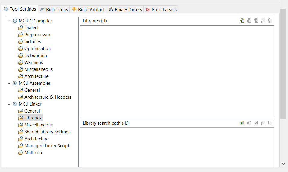

Hi All
Any ideas as to how to use math functions in MCUXpresso?
The project in hand can't link due to missing math library, eg
FLASH_target/../Applications/Project/time.c:213: undefined reference to `sin'
FLASH_target/../Applications/Project/calculations.c:219: undefined reference to `tan'
FLASH_target/../Applications/Project/calculations.c:220: undefined reference to `atan'
... etc.
Normally I add -lm to link in the GCC math libraries but this has no effect here.
In the project properties there is a tab to add libraries but which one is needed, or which path?

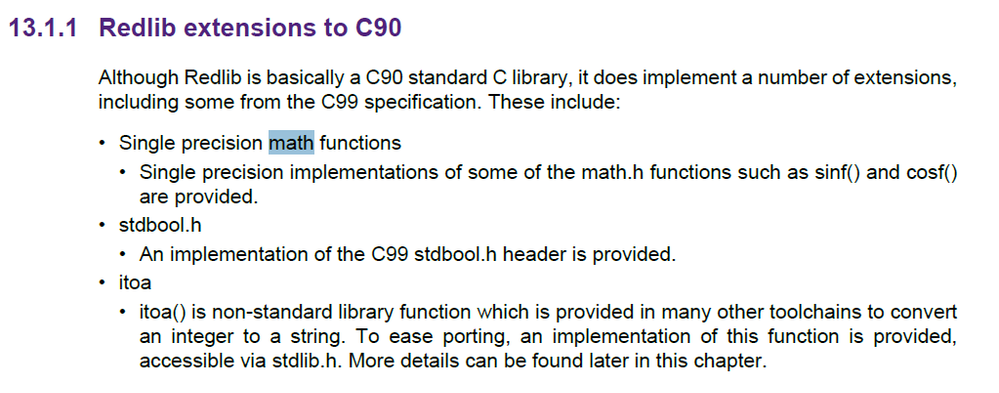

Searing in the IDE user's guide the only reference too math is with respect to Redlib extension:

I note that Redlib, Newlib or NewlibNano can be used when the setting is to use managed linker script mechanism, which look to include libm.a.
Since managed linker script is not being used the advice is to modify the linker script to add entries before the SECTION line, whereby if I have understood correctly it needs
"GROUP (libgcc.a libc.a libm.a libcr_newlib_none.a)"
to be added.
This hasn't been tried (yet) because the linker script file is shared with other GCC projects and the preferred method would be to add the appropriate library in an IDE setting as shown in the first image. Since there are 21 occurrences of libm.a in the MCUXpresso directories the question is how to chose the correct one for a particular processor and keep it compatible when changing between M0+ and M4 cores with and without FPU (which seems the big advantage of the -lm option that is not working)?
