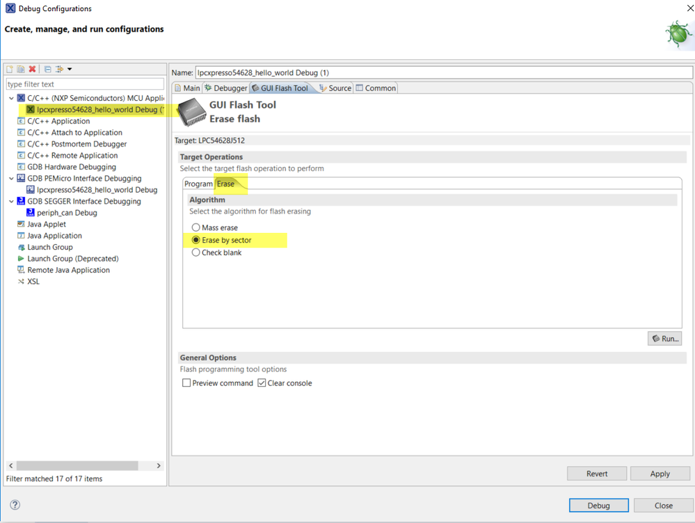

I am using the KM34Z256VLL for a metering application.
My question is about the GUI Flash Tool.

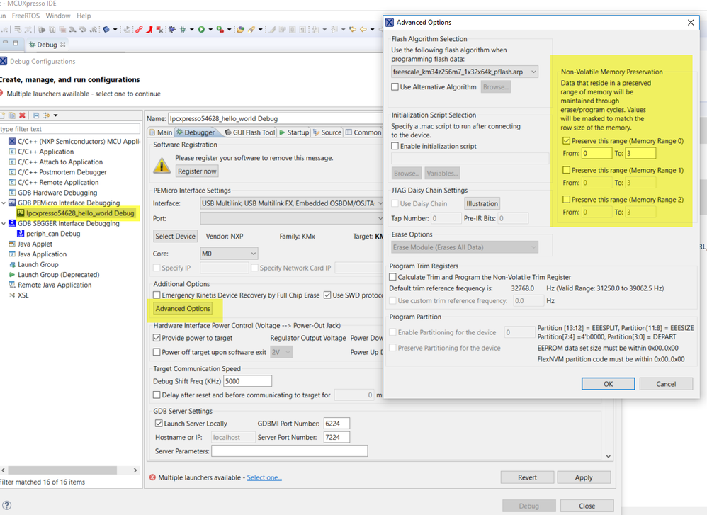

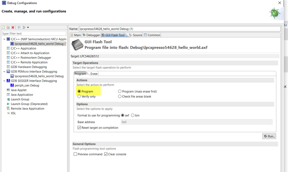

I have calibration data in a separated flash area (3f800 - 40000) that must not be deleted, but I would like to flash altered firmware on the device. Is it possible to flash until a certain address without deleting the rest? Technically this should work, but I can't find out how to do this. (Maybe with the "Additional Options" in the GUI Flash Tool)

Hello Jens Wagner,
If use P&E debug probe, in debug mode, there is this function :
If use J-link, you can sue J-Llink Commander :
J-Link Commander | SEGGER - The Embedded Experts
If use CMSIS-DAP, try to erase by sector , then Program:
