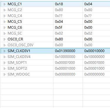

   Recently I updated my MCUXpresso Config Tools from V2.0 to V5.0, but it's quite curious that the file clock_config.c created by the new version of the tool is not able to make it work with the old project... And this just occurs in DMA transfers.
But it seems that there's no difference between the old config tool and the new one. I'm confused...I want to know how this happened, and how to fix this if possible.Should I go back for the old version or not?
The MCU in this project is MKV58F1M0VLQ24.I would be appreciate it for your help.

863308681
Hi Alice_Yang,
   Thanks for your quick response.I compared these flies you mentioned after I recived the reply and found the problem.
It seems the value of SIM_CLKDIV1 calculated by the config tool is the only reason. The new version can support up to 50MHz of external reference clock and the old one is not available, so I calculated it myself in my old project, and the value is 0x1370000U, which is 0x1390000U when using the config tool. Here is the screenshots of the old project and the new one:
and this is the config tool:
Is there a bug in the config tool or not? Although the tool issued a warning, it still generated the clock_config.c.

863308681
Hello Marek,
Thank you for these suggestions. I'm pretty sure it's not feasible to config the project with MCUXpresso Config Tools. The only register I modified was OUTDIV4, which was configured in the tool to be 1001 (devide 10), and I modified it to 0111 (devide 8) so that the DMA interrupt could run properly. In the Config Tools, this register is used to control the Bus/Flash clock, and it cannot be configured to 0111. Obvoiusly, the option provided by the Config Tools is not correct.
I wonder if it is possible that the new version will not be able to pick the right value when it uses an external reference clock of 50MHz? If that's the case, I hope it will be fixed. If I had any unintentional mistakes in my configuration, please correct me. Here are my configuration: System clocks: 235MHz, Fast peripheral clock: 117.5MHz, FlexBus clock: 58.75MHz, Bus/Flash clock: 23.5MHz. The External Reference clock is 50MHz.
