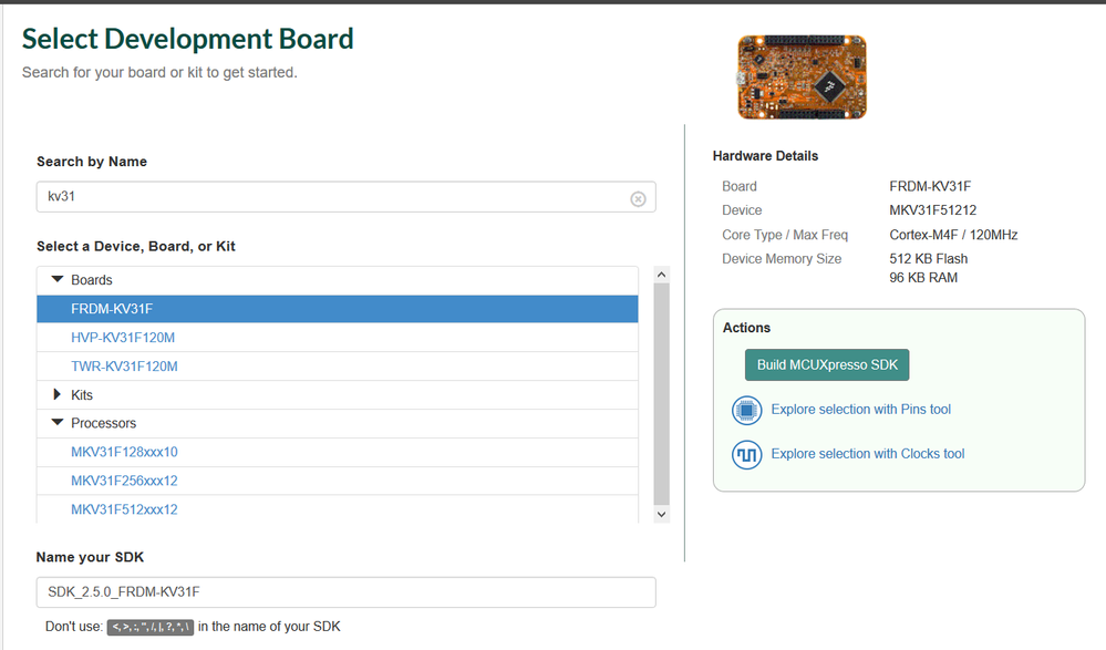

I'm using KV31F FTM1 ch1, FTM2 ch0, FTM3 ch1 as an input capture on both edges. The channels are generating interrupts, however the CnV value is only loading 0's. Is there a required command to start the CNT with input capture mode or a required way to read the Cnv?
Please see attached FTM1 ch1 Initialization code.

I strongly recommend you first check the input capture demo under MCUXpresso SDK.
Download from https://mcuxpresso.nxp.com/en/select ,
it support MCUXpresso IDE, IAR and KEIL.

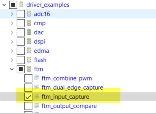

There is a demo named "ftm_input_capture" under "driver_examles" folder:
