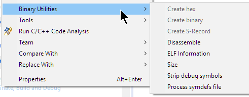

The MCUXpresso IDE offerst various binary tools in a context menu too:
