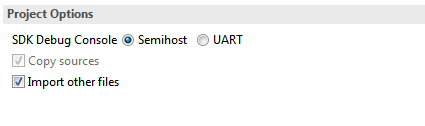

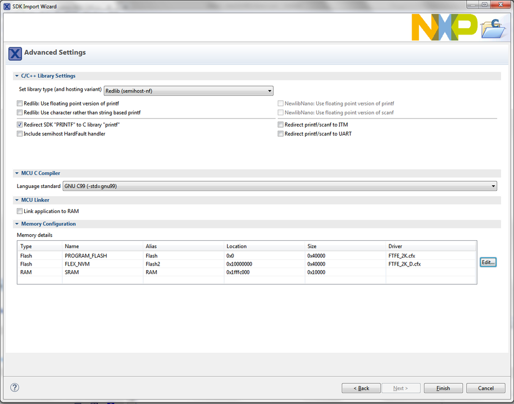

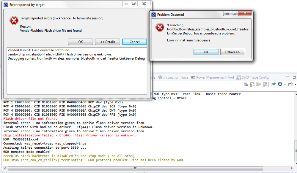

For Wireless_UART BLE example project I got the following error:
Default configuration:
Error:
After changing the config:
Error:
In both the case, the debugging option looks like this
Semihost option is selected
9,714 Views
stephanie_m
That might be the root cause of your issue, could you please try debugging and deploying the firmware using the UART interface? Do you still get the errors?
Estephania
9,714 Views
nsuresh2
estephania_martinez
Once after changing it to UART interface it is working fine!
Thanks for your support!

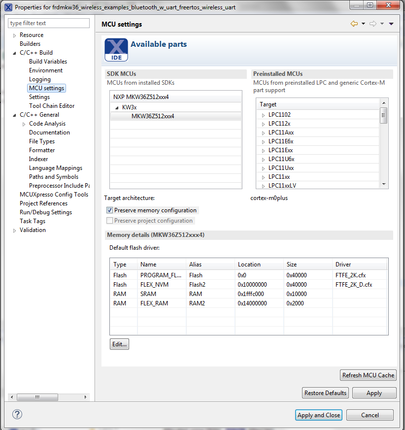

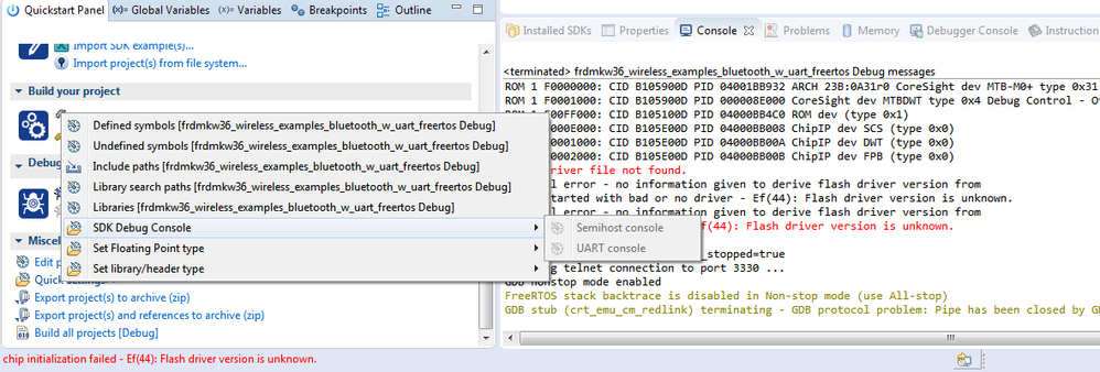

Is there any option to change that setting from semihost to UART once after setting up the project using SDK import wizard
Because I could able to see that option only during import SDK examples (SDK import wizard)
Please let me know the steps to change it
Thanks!
9,714 Views
stephanie_m
Yes,  there is a way to do it either right-clicking the project or in the properties of it.

2. When I try to write some data in the FlexNVM memory part it is not writing, please refer the below memory configuration
Thanks!
