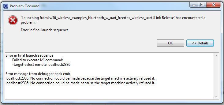

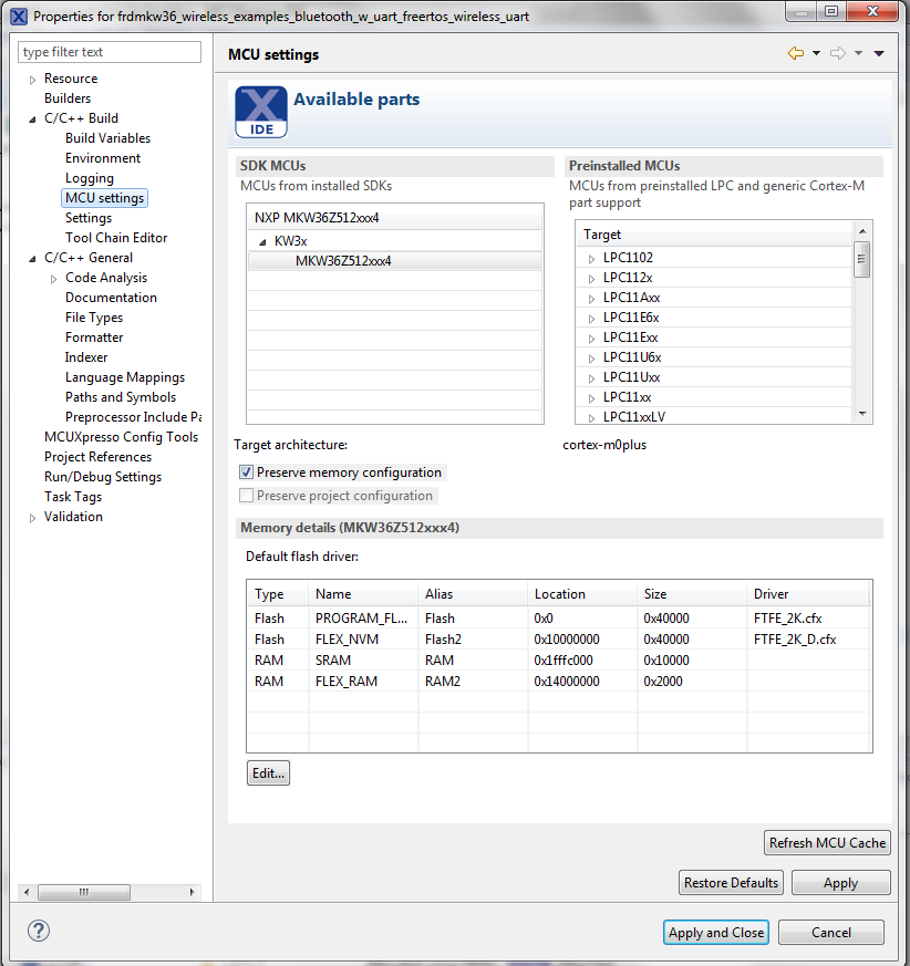

Hi estephania_martinez,
kw36‌mcuxpressoide_10.2.1_795 segger jlink #flexnvm‌
I am using Segger J-Link Plus debugger to download and debug the source code to KW36 board
For the Wireless_UART BLE example project
  1. When I download the debug version of the project it is uploading properly
Whereas when I download the release version of the project it is showing the following error
Error in final launch sequence
Failed to execute MI command:
-target-select remote localhost:2336
Error message from debugger back end:
localhost:2336: No connection could be made because the target machine actively refused it.
2. When I try to write some data in the FlexNVM memory part it is not writing, please refer the below memory configuration
Thanks!

stephanie_m
Could you please add this issue in a different thread?  This issue seems to be different also I will need more details on how you are deploying it, also, are you trying to debug the release version? Or are you just flashing it?
