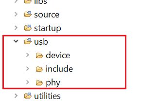

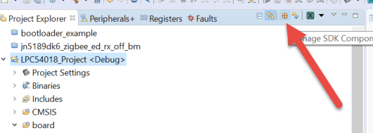

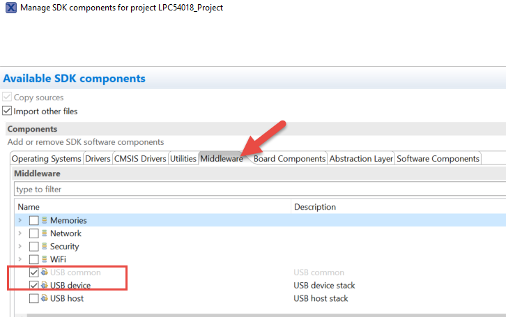

ZhangJennie
First you need make sure both GUI program and HID program works separately.
then you import your HID code into your GUI program.
steps:
1. add USB component to your GUI project
2. after import you will see USB driver added in project:
Thus you have imported all USB device driver source codes into your project.
next you can either add your HID application source code into your project directly.
or
refer this document from step 5 to create your HID application
https://community.nxp.com/docs/DOC-347301
Jun Zhang
