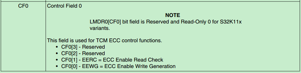

how Can i enable/disable the ECC function? and what's the meanning of this fowlling picture.

Please refer to this example.
Example S32K14x SRAM ECC Injection
The ECC read check and write generation are enabled by default on the SRAM regions that support ECC.
