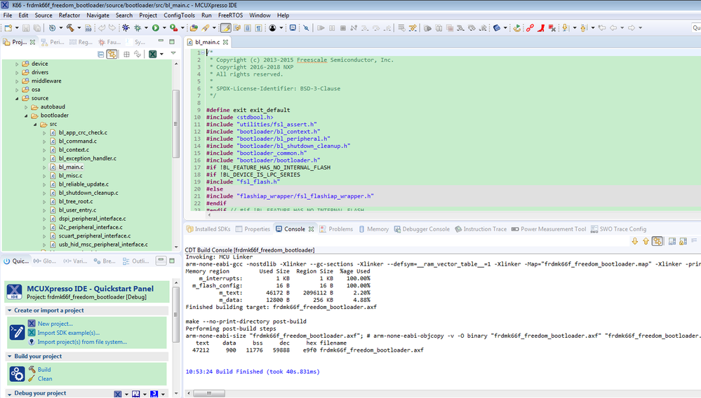

When I build the official bootloader it is unsuccessful because I get an unresolved inclusion for wchar.h.
Curtis
10,551 Views
kerryzhou
Hi Curtis,
   What the IDE you are using?
   Please refer to this project:
Use SDK_2.5.0\boards\frdmk66f\bootloader_examples\freedom_bootloader
 Please update the IDE to the new version.
If you still have the problem, please also give me the error picture, and tell me your IDE version.
Kerry
10,551 Views
curtis_robertso
I am using the SDK 2.5 and IDE 10.3.1.  The errors I get are below.
10,551 Views
kerryzhou
Hi Curtis Robertson,
   Please refer to this SDK doc:
KSDK_2.0.0\SDK_2.5.0_FRDM-K66F\docs\Getting Started with MCUXpresso SDK.pdf
Chapter 3 Run a demo using MCUXpresso IDE
You need to : Drag and drop the SDK zip file into the “Installed SDKs” view to install an SDK.
Do you do this operation before your build and import the frdmk66f_feedom_bootloader project?
  This is my build result:
No errors.
Please refer to the doc, and import build the project again.
kerry
