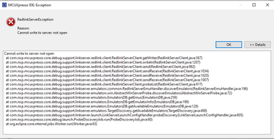

i have a Problem to connect my iMXRT1170 Evalboard via the On-Board Debugger with MCUExpresso. If i press the Debug Button, loaded the Blinky example before, i get the error message "An internal error occurred during: "Opening RedlinkServer telnet session...""

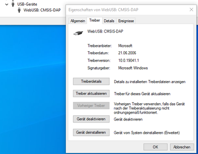

In the device Manager from Windows i see the CMSIS-Dap:
In the Details.txt of the Eval-Board is the Version:

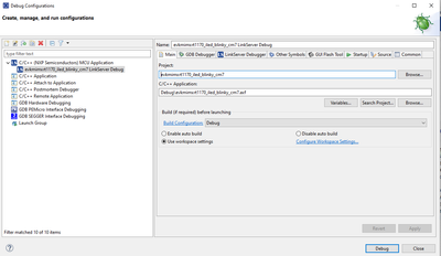

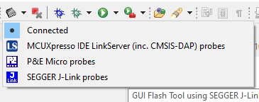

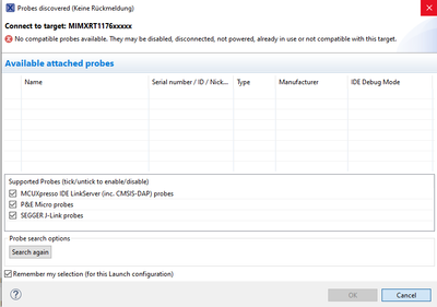

here are another Exception that is shown from MCUXpresso when i try to connect.
I now found the Debug Configurations,
there was no entry on "C/C++ (NXP Semiconductors) MCU Application", i double clicked on it and then there appeared the entry "evkmimxrt1170_iled_blinky_cm7 LinkServer Debug"
But the Error is still the same.
Also under the "Probes discovered" Window it says "No compatible probes available. ..."
