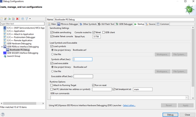

arnogir
Senior Contributor II
I can't make the check today and I will test tomorow,
But maybe this "Offset" is the solution?:
3,913 Views
ErichStyger
Specialist I
that offset is added to the symbols you load. This is useful if you have linked the binary to a given address, but then in memory you load it to an offset of this. That way the debugger can correlate addresses with symbols.
