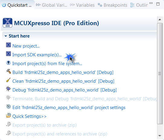

1) Click on the Import SDK example option from the Quickstart menu:

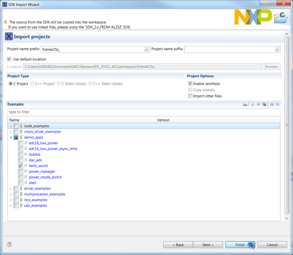

2) For this demonstration the Hello World example is used:

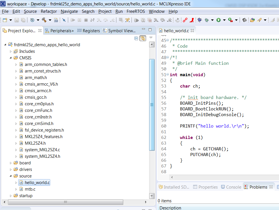

3) The new project should now appear on your workspace:

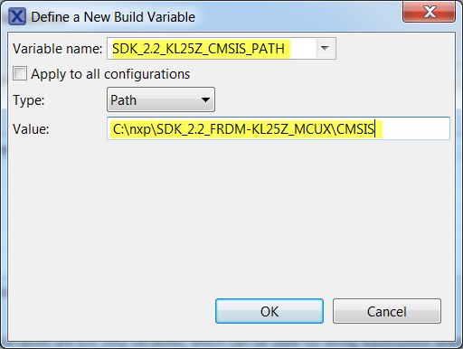

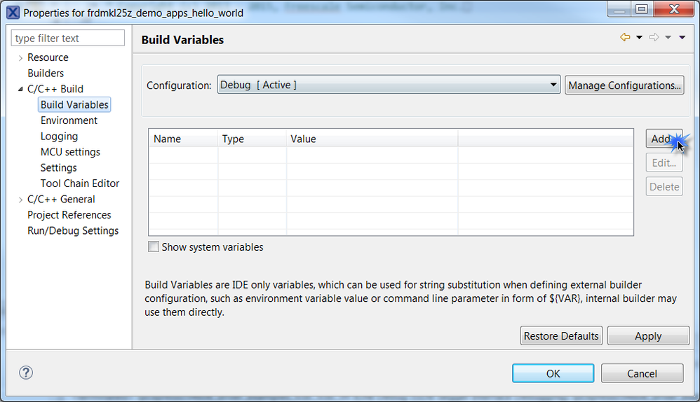

1) The first step is to create a build variable that will be used to specify the path of the DSP library. Go to Project > Properties and under C/C++ Build select Build Variables and click on Add:
2) A new window will open, specify the name of the build variable, its type and value, the Value is the location of your CMSIS folder:
Variable name: SDK_2.2_KL25Z_CMSIS_PATH
Value: C:\nxp\SDK_2.2_FRDM-KL25Z_MCUX\CMSIS
NOTE: The SDK_2.2_FRDM-KL25Z package was previously unzipped to the C:\nxp folder
3) The new variable should be listed as in the image below, click on Apply:

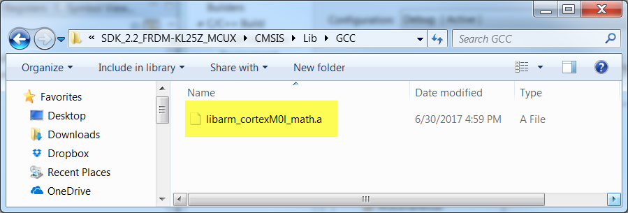

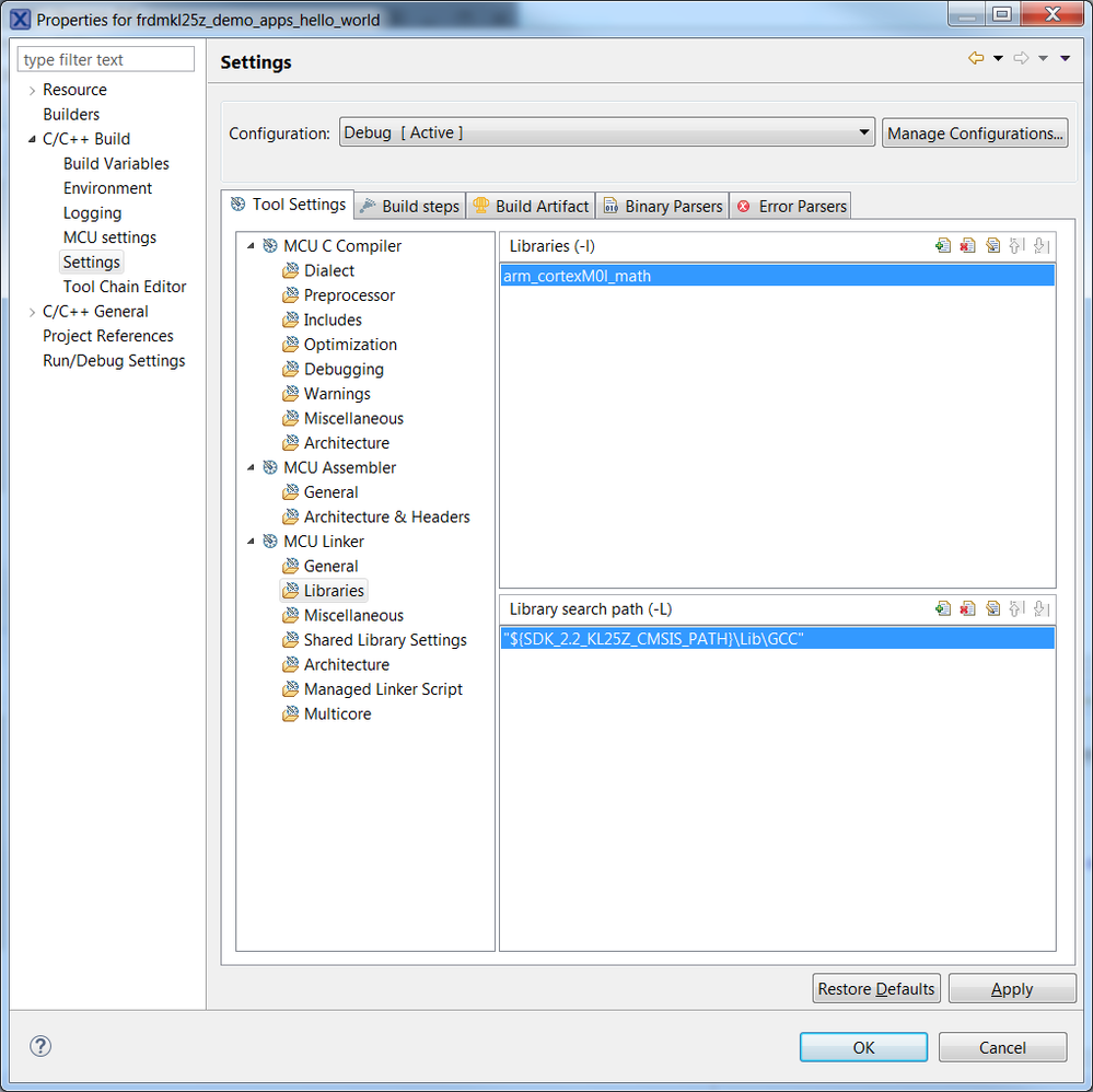

4) Go to C/C++ Build > Settings > MCU Linker > Libraries and specify the precompiled library to be used and its path:
Library name: arm_cortexM0l_math.The M denotes the ARM core, while the ‘l’ means ‘little endian’.
Path: ${SDK_2.2_KL25Z_CMSIS_PATH}\Lib\GCC
5) Now go to C/C++ Build > Settings > MCU C Compiler > Preprocessor and specify the following macro:
ARM_MATH_CM0PLUS: Tells the CMSIS library which ARM Cortex core I’m using.

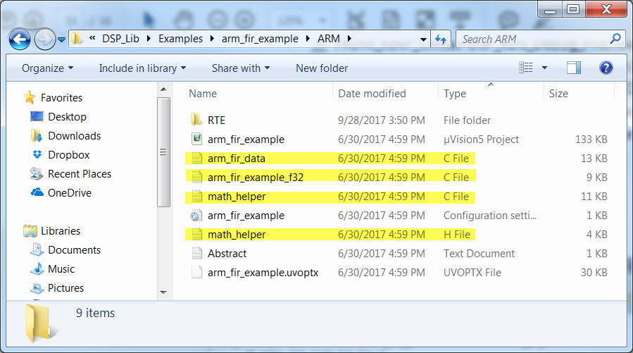

1) For this project the “FIR Lowpass Filter” example will be used, it can be found on the following path:
${SDK_2.2_KL25Z_CMSIS_PATH}\DSP_Lib\Examples\arm_fir_example\ARM
2) The first step is to copy the source files of the example to the project, the files that need to be copied are:
arm_fir_example_f32.c
arm_fir_data.c
math_helper.c
math_helper.h
3) The next step is to copy the SDK include files and initialization functions from the hello_world.c file to the FIR example file:
#include "fsl_device_registers.h"
#include "fsl_debug_console.h"
#include "board.h"
#include "pin_mux.h"
BOARD_InitPins();
BOARD_BootClockRUN();
BOARD_InitDebugConsole();
4) Finally the hello_world.c file can be deleted from the project:
5) Now you should be able to compile and debug the project.
