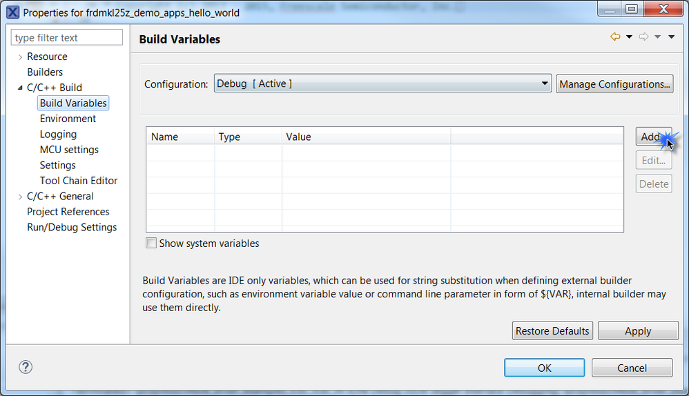

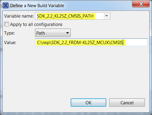

1) The first step is to create a build variable that will be used to specify the path of the DSP library. Go to Project > Properties and under C/C++ Build select Build Variables and click on Add:

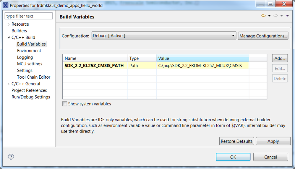

2) A new window will open, specify the name of the build variable, its type and value, the Value is the location of your CMSIS folder:
Variable name: SDK_2.2_KL25Z_CMSIS_PATH
Value: C:\nxp\SDK_2.2_FRDM-KL25Z_MCUX\CMSIS
NOTE: The SDK_2.2_FRDM-KL25Z package was previously unzipped to the C:\nxp folder
3) The new variable should be listed as in the image below, click on Apply:

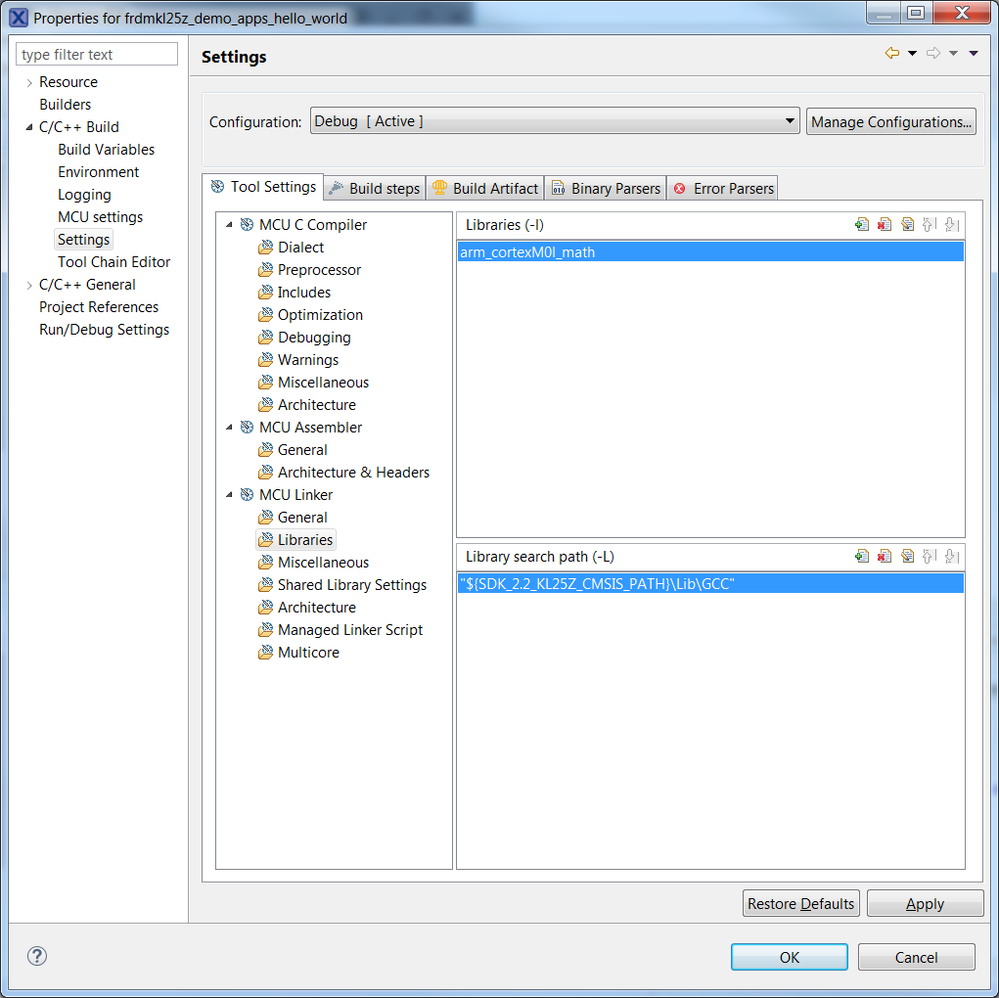

4) Go to C/C++ Build > Settings > MCU Linker > Libraries and specify the precompiled library to be used and its path:
Library name: arm_cortexM0l_math.The M denotes the ARM core, while the ‘l’ means ‘little endian’.
Path: ${SDK_2.2_KL25Z_CMSIS_PATH}\Lib\GCC

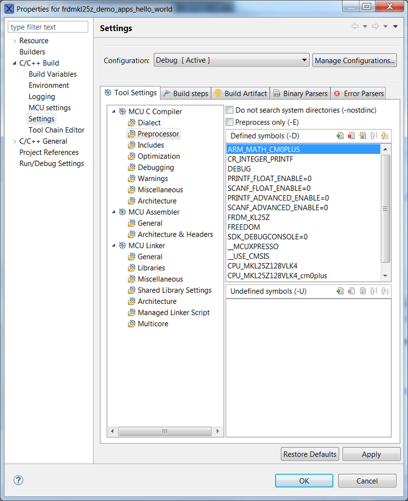

5) Now go to C/C++ Build > Settings > MCU C Compiler > Preprocessor and specify the following macro:
ARM_MATH_CM0PLUS: Tells the CMSIS library which ARM Cortex core I’m using.

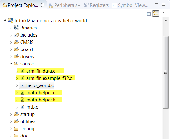

2) The first step is to copy the source files of the example to the project, the files that need to be copied are:
arm_fir_example_f32.c
arm_fir_data.c
math_helper.c
math_helper.h

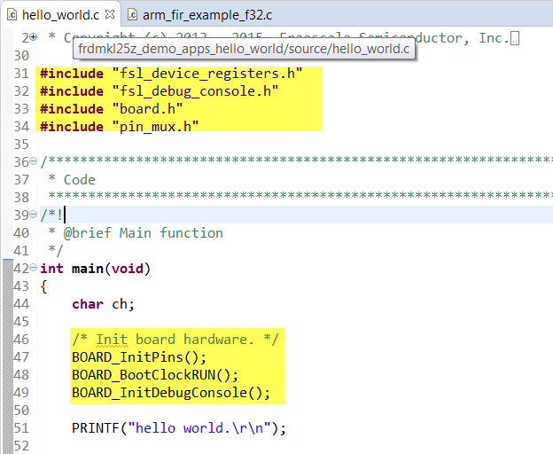

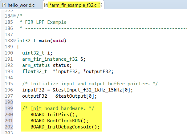

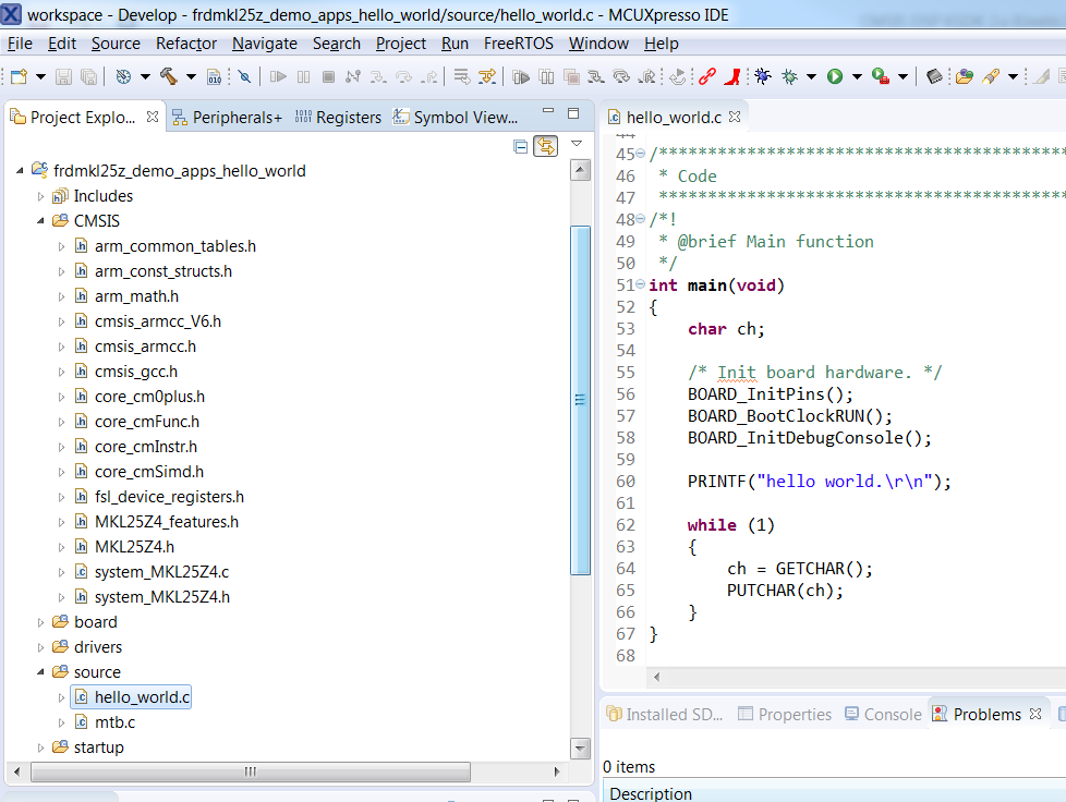

3) The next step is to copy the SDK include files and initialization functions from the hello_world.c file to the FIR example file:
#include "fsl_device_registers.h"
#include "fsl_debug_console.h"
#include "board.h"
#include "pin_mux.h"
BOARD_InitPins();
BOARD_BootClockRUN();
BOARD_InitDebugConsole();
4) Finally the hello_world.c file can be deleted from the project:
5) Now you should be able to compile and debug the project.
