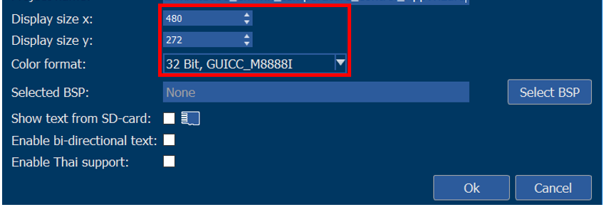

  6. Or manually select the display size and color format if the device and display you are using is not available in a predetermined BSP.   (NOTE:  If you don't select a BSP, you will need to create the Target/GUI_Lib folder manually to get this tutorial to work. The directions for this are presented later in the document.)pastedImage_4.png                                                                    The last three check-boxes are optional selections that enable SD-card support, bi-directional text support and Thai language support.
