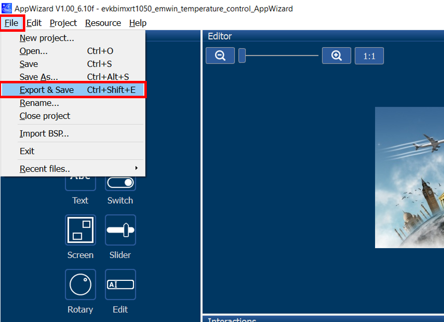

  9. Finally, click File->Export and Save.  This will generate the AppWizard files necessary to program your development board. pastedImage_1.png

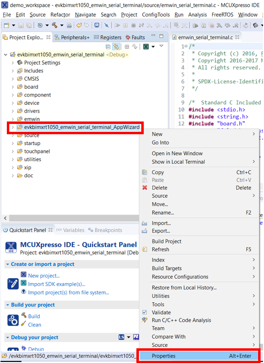

  1. In the MCUXpresso project, first find the AppWizard project folder in the MCUXpresso Project Explorer. Right click on the folder and select Properties as shown.  pastedImage_3.png
  2. Select Settings in the C/C++ Build Category.  Ensure that "Exclude resource from build" is unchecked, and click Apply and Close.  pastedImage_6.png

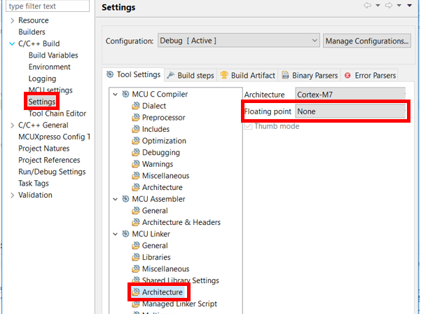

  7. In the C/C++ Build -> Settings category, select MCU C Compiler -> Architecture.  Change Floating point to None as shown. pastedImage_13.png
  8. In MCU Assembler -> Architecture and Headers, change Floating point to None as shown.  pastedImage_14.png
  9. In MCU Linker-> Architecture, change Floating point to None as shown.     pastedImage_15.png
