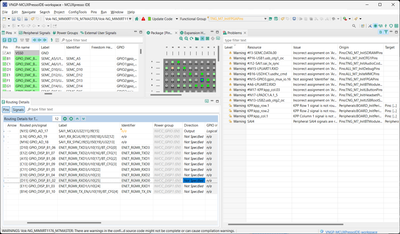

Hello All,
I'm am finalizing a rather dense pinmux based on RT1170-EVK for a devkit of our own, and I'm getting direction assignment incompatibility warnings in MCUXpresso, when setting a direction for a GPIO pin, thewarning pertaining to an apparently unrelated set of other pins.
I need to understand what is the dependance, and how I can check it, how this is documented ?
for instance when setting direction for SAI1_MCLK/U32[11]/J9[15] ([N15] GPIO_AD_17)
I get a warning for a bunch of unlrelated pins, for instance  SEMC_D0/U13[2] ([F3] GPIO_EMC_B1_00),n that cannot even be allocated to the same function (GPIO3)
So cna I just go ahead and ignore those warnings (I'd rather not), or have I missed something ?

HI Peter,
thanks. I installed MCUXpresso 11.10 and updated the rt1170-EVK SDK to v2.16.
It is slightly different now, but with more of those apparently unrelated pins reporting arrow correcteness issues.
The pins are the ones reported by Lui in his post above. I will try with the standalone tool once our anti-virus lets me do so, but I assume it will give the same result. I'm not sure how I'm supposed to fix this: if you consider {pin_num: F3, peripheral: SEMC, signal: 'DATA, 00', pin_signal: GPIO_EMC_B1_00}, it is correctly assigned to SEMC, and the tool will not allow me to change the direction. The displayed arrow is one-dir (->), but this DATA signal makes sense as bi-dir, and the Direction column does indicate "in/out" which is ok.
If I rollback my direction setting for N15, the Arrow column for F3 goes back to "<->" and the warning goes.

Petr_H
We have now been able to to reproduce the problem now. It's a bug in the Pins tool, after the change of the direction in some specific situations with mulitple functional groups, the tools starts to incorrectly report the "Incorrect assignment on 'Arrow' item' problem.
We are sorry for the inconvenience. We will fix the problem in the next update of the MCUXpresso Config Tools, including the MCUXPresso IDE integrated version. As a workaround for now, please ignore this warning.
