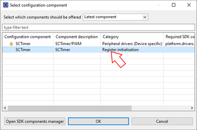

I have to Cofigure SCTimer/PWM for my Application using MCUXpresso Configuration tools. How to do this ? what all parameters setting should be necessary while configuring for this SCT/PWM ?Any video link or Documentation would be really Appreciable.

Recently, there was introduced a new register init component for SCTimer configuration and initialization. I recommend using this new component as it provides full capabilities of the SCTimer peripeheral and it generates a simpler code with lower memory footprint.

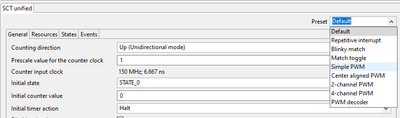

It also provides a set of presets for several basic use-cases that can be selected using the 'Preset' combo box in the SCT section. You can select some of these presets an then continue tweaking the individual settings :
If you are new to the SCTimer topic, it may be interesting for you to check the SCT cookbook available here .

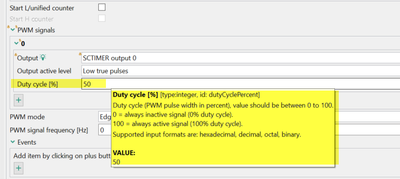

Hello Deep_Bang,
Sorry there is no such video or document.
This configuration tool is easy to use, there is some reminders in every configurations, for example:
