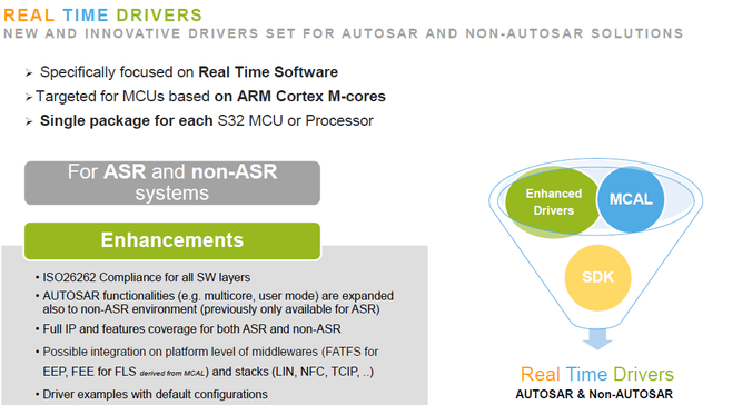

3.RTD includes SDK(Drivers) and mcal. If there is no AUTOSAR requirement, you can use Drivers.
