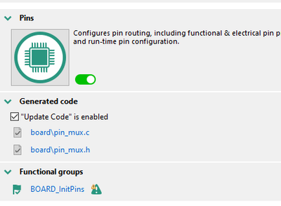

It occurred to me that perhaps I should only define the GPIOs with the Connfig Pins tab and not the Peripherals tab, but if I take them out of Peripherals then BOTH of the generated GPIO pin initializations are removed.
I agree, you should only define the GPIOs with the "Pins" tool. That's the way I do it and the tool correctly creates initialization code.
Maybe "calling initialization" is not enabled. This is what is my "Pins" tool looks like:
Cheers.
2,707件の閲覧回数
JackNXP
You're right, that does work. Not sure what I did wrong before. The config Peripherals tool does show a warning that GPIOs are not initialized, but the BOARD_InitPins() code does get built to do the job.
Saves about 2KB flash in my app.
Thanks.
