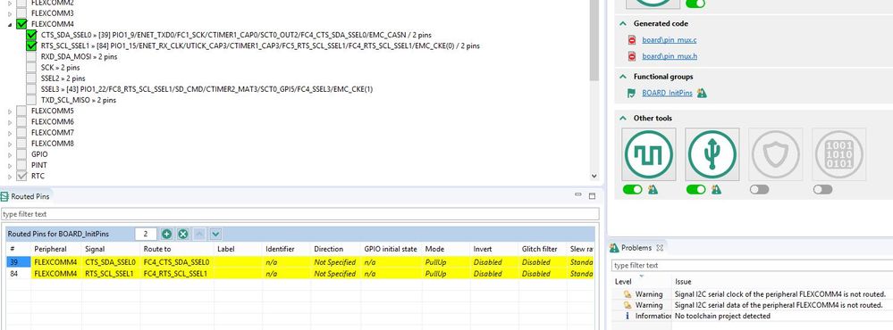

Hi there,
pls see attached screen dump
Signal I2C serial clock of the peripheral FLEXCOMM4 is not routed ...........
Under pheripheral signals I have selected PIO0_19 for serial CLOCK, and PIO0_18 for serial DATA.
CONFIG TOOL version 6.
What is causing the warning ?
regards
Viggo

Hi Viggo,
this validations are done in Peripherals tool. If you have configured FLEXCOMM4 to certain mode, it recommends to route corresponding pins needed in the mode, to ensure peripheral works well.
If this answer does not help, please provide a configuration file (*.mex), so we can analyze details.
Marek

Hi Marek,
the warnings only shows up in Config Tool v6. Not in v4.1 see inserted pictures.
How to attach files in a reply ?
Viggo
