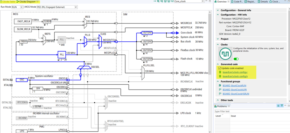

I want to make some clock settings, I want to change the clock values of the system, the bus and the core.
But I'm not sure if it's in the clock_config.c file, can someone help me
Tags (3)
3,955 Views
marek-trmac
Hi Oswaldo,
the file on the screenshot contains clock configuration file for new project created for processor, i.e. the file contains default clock configuration (bus and core). It is possible to import this configuration into Clocks tool, modify and update the file.
Marek
Marek
NOTE: If you find the answer useful, kindly click on [ACCEPT AS SOLUTION] button
3,955 Views
Hello Oswaldo Tovar,
Yes, you can config clock_config.c and clock_config.h files.
Also you can use MCUXpresso config tool about config Clocks to config it , then generate code,
this also set the code in clock_config.c and clock_config.h files:
