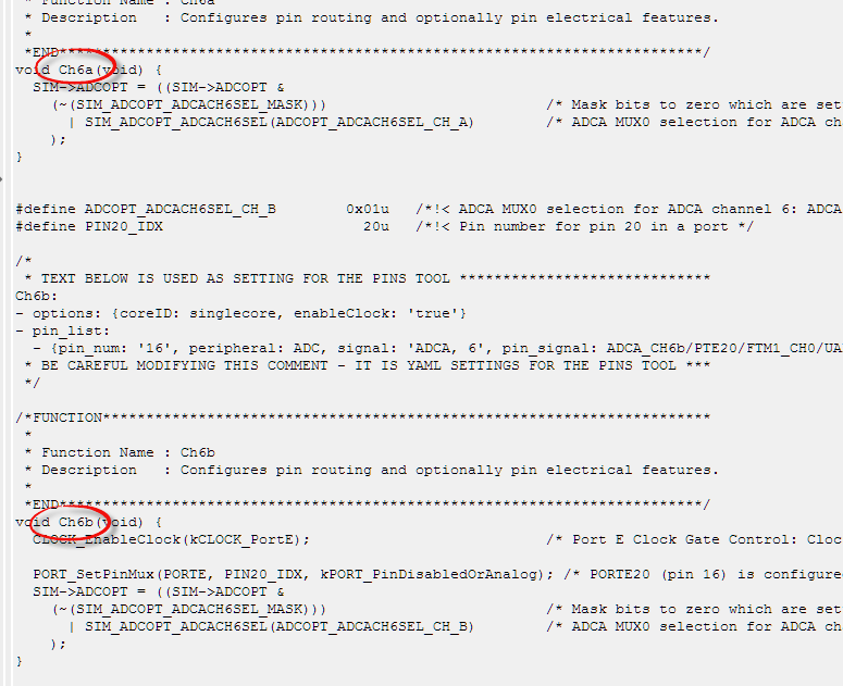

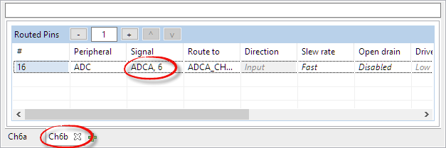

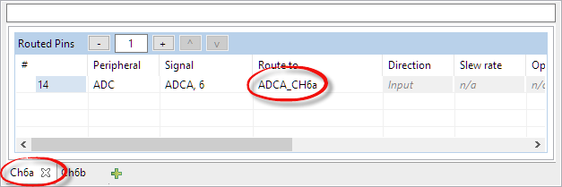

For switching muxing at runtime you can create functions. For this you add a 'tab' in the routed pins view (you can give each tab its own name):
That way you can have both sub channels be configured, as they won't be active at the same time:
And you have two functions (named after the tabs) you can call for the muxing from your application:
