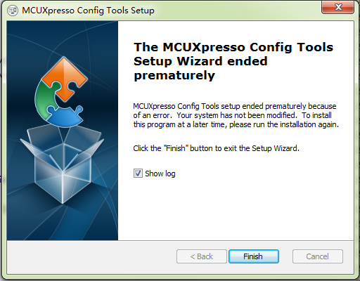

When i install the MCUXpresso_Config_Tools_v3_x64.exe(lasted version), it will get the error dialog:
Attach is the log.
Original Attachment has been moved to: MSI208A.LOG.zip

Hi Liang,
We issued new version of the tools.
The issue you reported should be fixed in new build now.
MCUXpresso Config Tools, Windows 64bit package (REV 3.0.2)

brianzelle
Sorry to post on an old thread but I'm having the same issue with versions 4.0 and 4.1 of the Config Tools. I tried all of the suggestions above but have not had any success. Any other suggestions?

martinformanek-
Hello, please try our latest released version of MCUX Tools, issue should be fixed now.
please let me know if it solved your issue or not.

brianzelle
Hello, I finally got around to trying this and it displayed the same error. However, the install worked well enough that I can run the software.

tonyyang
My system:
Windows 7 64bit SP1 v1.0
JRE1.8
8 GB RAM
1600x900 display resolution.
Internet connection.

martinformanek-
Hi Liang,
This failure is most often caused by the lack of or corrupted registration of the Microsoft OLE Automation library OLEAUT32.DLL.
ou should confirm that this file is installed on your target system, and that is is correctly registered using regsvr32.exe.
Could you please try to register all the folllowing DLL files from administrator Command Prompt:
regsvr32.exe vbscript.dll
regsvr32.exe oleaut32.dll
regsvr32.exe jscript.dll
regsvr32.exe msxml3.dll
regsvr32.exe -i shell32.dll‍‍‍‍‍
please restart the machine and check if problem still persist.
2. You can also try to register the windows install service
C:\Windows\System32\msiexec.exe /regserver‍
3. There is also some chance, that scripts run by installer might be blocked by antivirus program. Please try to disable it before installation.
4. If issue still persist, could you please send me your oleaut32.dll file? I will try to reproduce the issue on our machine.
