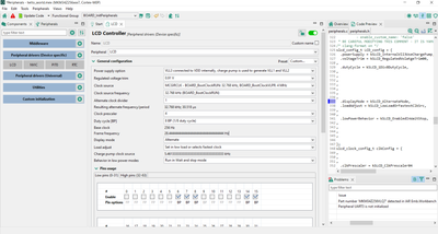

Hello, i'm using config tools for nxp mcu mkm33z64a to generate generic peripherals such as PIT, UART, etc..
I have faced an issue that mcuxpresso doesn't generate some of the peripheral config variables for following peripherals (SIM, UART, PIT).
For example, mcuxpresso config tools doesnt create a variables for baudrate but initialization header show that "baudRate_Bps: '115200'"

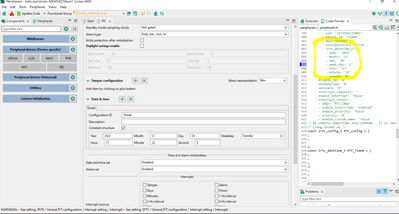

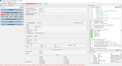

Another example which generated code for a RTC module, when i created a default time for test purpose using mcuxpresso config tool then generated code doesnt not have any time struct.

const irtc_config_t RTC_config = {
const irtc_datetime_t RTC_Time0 = {

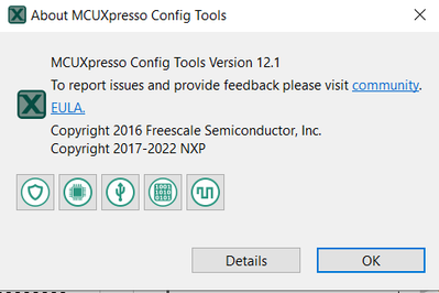

I'm using latest version MCUexpresso config tools and Kinetis MCU SDK's which downloaded from mcu expresso sdk builder online tool. My toolchain is created for IAR Embedded Workbench.
Is this a bug? Is there any workaround for this?

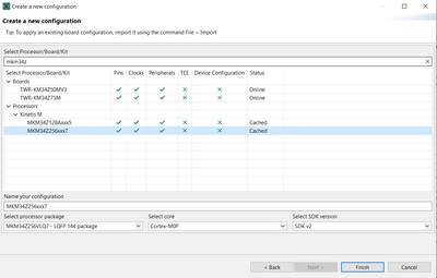

muratdemirtas
Hello again Raul,
        for double confirmation, i have created a new project using only mcu expresso config tool without entering sdk path. I have enabled RTC clock and just set the default time to current time but as you can see there is no data for RTC_Time0. The code was not generated at this step, i'm leaving code preview tool screenshot below.

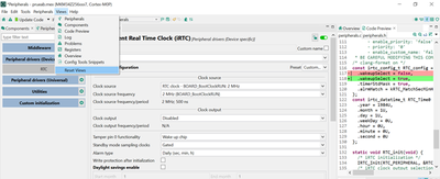

  • After modifying the RTC, do you see a change in color (highlight) in the Code Preview window?
  • What OS are you using?
Meanwhile, please try out the following recommendations for solving your problem:
  1. Enter ConfigTools in the toolbar, click on Views -> Reset Views. If this doesn't solve it, click on Help -> Check for Updates.

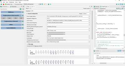

I can see the modified values highlight's on the code preview but this occurs on generated struct variables. Other struct values couldnt generated from config tool(this is the error). I'm attaching the screenshot.
This error occurs on every peripheral on MCU when using config tool.
For talking about SLCD display mode, i'm changing lcd display mode then highlight shown but other values such as slcd clock config doesnt created by config tool.
highlighted
Not highligted, struct variable not generated

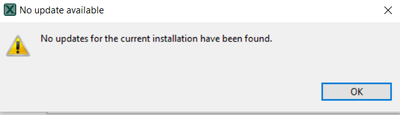

Reset views is not solved this issue. Check for updates returns that

Second: Have you tried use the MCUXpresso Config Tools with another microcontroller? Maybe would be useful if you try with the MKM33Z64A, as you mention it at the very beginning of this thread.
Both two microcontroller mkm33z64a and mkm34z256 are has the same issue for config tool code generation. I'll wait them until new config tool version released.
