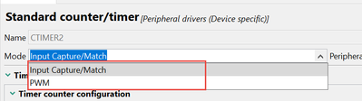

Does ConfigTools support configuring the LPC54102 Standard Counter/Timer (CTIMER) peripherals in Counter mode rather than in Timer mode?

Hi BTaylor,
CTIMER in peripherals tool only support Input Capture/Match mode and PWM mode. see below

ZhangJennie
Hi BTaylor,
 Hope this helps,
