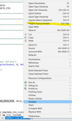

Hello, my name is Pavel, and I will be supporting your case, if you want to know the root of a macro you could use CTRL + click on the macro, otherwise with the mouse on the macro, right-click and select toggle source.

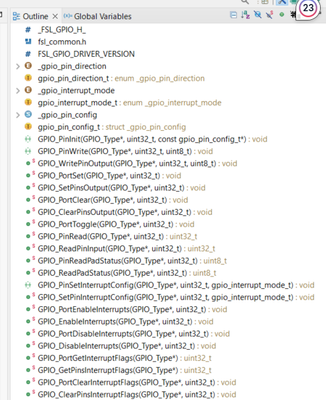

if you want to find a function, on the window Outline you could find all the functions on the .h or c depending on the document that you are.
