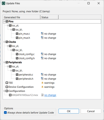

Newton829
Hello NXP Team,
Thank you for the prompt response.
Consider this example
1.my    *.mex   is present at "./ " location
2.By default the config tools will generate codes at location ./board after creating a board folder.
3.I want the code to be generated at ./loc_a/loc_b/
  Could you please provide an example how to mention the path?
Thank you,
2,145 Views
liborukropec
Hello Newton,
Output Path Override settings for your example is:
Expression:
board/(.*)
Replacement expression:
loc_a/loc_b/$1
resulting into this:
I hope it helps.
