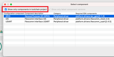

OK, I understand. So, I attach screenshots and a test project. I just noticed that the same problem is with I2C. SPI, I2C, USART and I2S drivers are added to the project. Only USART and I2S do not report a warning and are visible in the Components tab (scr1.png) while SPI and I2C have a warning in the Peripherals tab (scr2.png, scr3.png) and do not show in the Components tab.

Thank you. Now I think I understand the origin of the issue. There is a check-box "Show only components in toolchain project" that is present only when you use the components view and which provides additional filtering that shows only SDK components that have already been added using the "Manage SDK components" in the IDE project explorer or during the project creation.
To achieve the same behavior, you can uncheck this checkbox and all available component should be offered.
Does this resolve the issue for you ?
Just additional note - once you add a component that reports the error "driver not found in toolchain project" in problems, you can used context menu command "Add SDK component .... into the project" to quickly add the component instead of returning to project explorer and adding the SDK component there.

Yes, I know about it. However the problem is that when the "Show only components in toolchain project" box is checked, SPI and I2C drivers should be displayed because they are included in the project. This was the case in previous versions of the SDK. In my opinion, the problem is related to the aforementioned warning on these drivers
Generally, for me in my "production" projects it is not a big problem - because the drivers work. But I have classes of embedded systems at the University, on LPC55s69 and this bug does not look right;)
27,919 Views
Petr_H
I see now So this is related the warning issue, as there is really a gap that that here is no UI configuration component exactly matching the version of SDK component you have in the project. It will be fixed when updated UI component is published (as described by Lukas). For now the workaround is to uncheck the checkbox and ignore the warning, sorry for the inconvenience.
