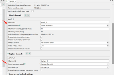

How can one use ConfigTools to configure input capture for a CTIMER? I cannot find anywhere in the tool where I can setup a capture input (channel, edge, etc.). Is this a case where I simply need to eschew the tool and configure things manually?
2,727 Views
BTaylor
I understand now that ConfigTools does not support Counter mode. It also seems, though, that it does not fully support Capture/Match mode either. It allows match channels to be configured, but I do not see any way to configure capture channels.
2,722 Views
ZhangJennie
Hi BTaylor
Match channel and capture channel are configured here: There are yellow  exclamation marks on the screenshot because the related pin is not routed. User needs to go to pin configuration tool to config the pin.
