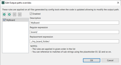

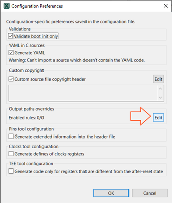

Regarding the issue 1 - changing output path - in the latest recently released version of Config Tools (V12) it's possible to override the path of the the generated files, so it should be possible to use the solution with the multiple .mex files.
To modify the path in the particular mex file, use the Edit -> Configuration Preferences command and there is Output path overrides section:
There you can Edit the set of rules that override the paths.
You can add for example a rule as the following one, that overrides the folder 'board/' in the paths to some relative path "../my_board_folder/" (you can tweak it as you need):
Now all the files that normally go to board folder will go to the one you specify. If you'd like you can create different individual rules for individual files like pin_mux.c etc.

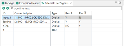

If you'd like to have additional information like (for example additional custom labels or features of pins) stored directly in the tool, there may be useful other new feature from Config Tools V12. You can create a completely customized user signals table, using the new External Signals View.
You can open it using View > External User signals. There you can add list of signals on your board, specify their connection to the processor and add columns with your information on the signals/pins.
Once the connection is specified, the tooltips show the information and state of the pisn and pins are highlighted in Package and Pins view. This table can also be imported and exported using .csv format (editable for example in MS Excel).
