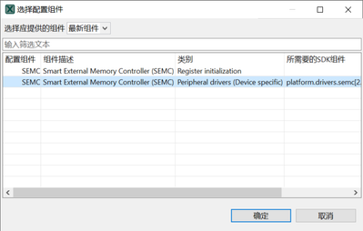

jingpan
HI @rmolde ,
This is the new function of V12. It only set SEMC register. Some people may like their code in this style.
You can select the second option. It is the traditional style and use driver to configure SEMC. Clock will be enabled in driver.
Jing
