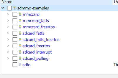

I am using the LPC54606J512BD100 MCU and need to connect an eMMC chip. However, I have found that MCUXpresso Config Tools V13.1 does not have an option to configure the SDIF module. The clock frequency is set to 180MHz, and the SDIO clock has been enabled. The corresponding SDIF ports are also configured. Is there any way to initialize the SDIF module configuration using MCUXpresso Config Tools?
Thanks!
1,708 Views
Hello @Gu01
Yes, the config tool doesn't support this module. There is demos under SDK, you can refer to:
