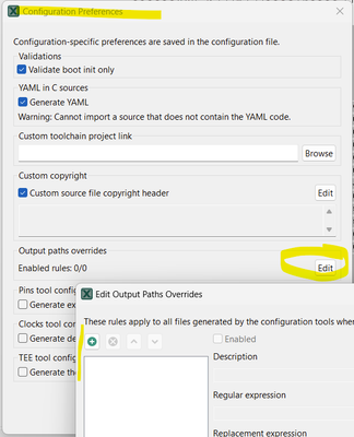

662 Views
liborukropec
Hello Newton,
do you have the MEX inside a IDE project? If yes, if the files are moved to other place in the project, Config Tools should detect the new location automatically (restart of Config Tools might be needed). If you use stand-along Config Tools and MEX configuration outside of IDE project, you have to use Output Path Overrides, available in main menu "Edit | Configuration Preferences":
Libor

618 Views
liborukropec
Hello Newton,
Output Path Override settings for your example is:
Expression:
board/(.*)
Replacement expression:
loc_a/loc_b/$1
resulting into this:
I hope it helps.
