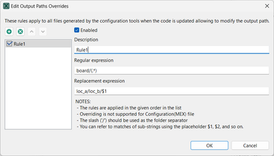

do you have the MEX inside a IDE project? If yes, if the files are moved to other place in the project, Config Tools should detect the new location automatically (restart of Config Tools might be needed). If you use stand-along Config Tools and MEX configuration outside of IDE project, you have to use Output Path Overrides, available in main menu "Edit | Configuration Preferences":

1.my    *.mex   is present at "./ " location
2.By default the config tools will generate codes at location ./board after creating a board folder.
3.I want the code to be generated at ./loc_a/loc_b/
  Could you please provide an example how to mention the path?

Output Path Override settings for your example is:
Expression:
board/(.*)
Replacement expression:
loc_a/loc_b/$1
resulting into this:
I hope it helps.
