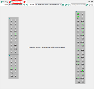

Step 1: Open the Expansion Header view
Open the Expansion Header view if it is not open.
    • In the standalone MCUXpresso Config tools, select the command Views > Expansion header
    • In the MCUXpresso IDE, select the command Window > Show view > Expansion Header

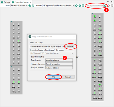

The application of the virtual adapter file is the same as the application of the expansion board definition file. Use the attached virtual adapter files.

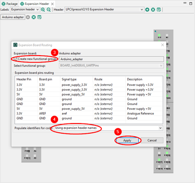

  1. Press the “Apply expansion board” button
  2. Locate the virtual adapter file and confirm
  3. Select if you want to create the functional group (recommended)
  4. Choose which names you would like to use in your source code
  5. Apply the expansion board

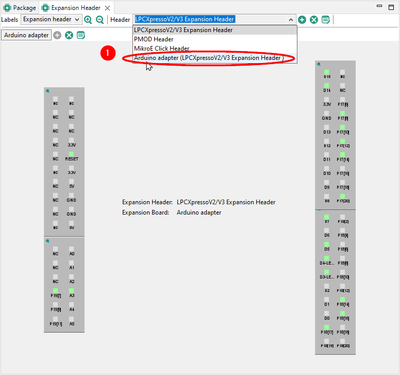

Step 3: Switch to the newly created header

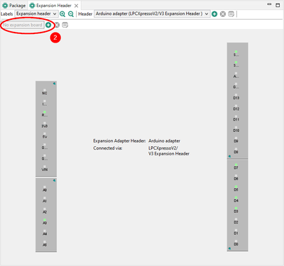

  1. Choose the Arduino adapter header option and select the newly created “Arduino adapter” header.
  2. Using the “+” button, select and apply an expansion board intended for the standard single-row Arduino header, and it will be connected to appropriate pins automatically.
