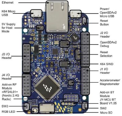

You can apply the Arduino Multifunction shield on several NXP boards. This tutorial uses the FRDM K64F EVK board.

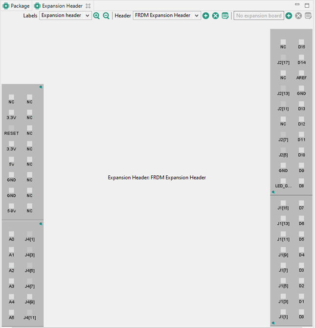

  • Open Expansion Header view (Windows -> Show View -> Expansion Header).
Figure 1 FRDM K64F EVK board
Figure 2 Expansion Header view in the Pins tool

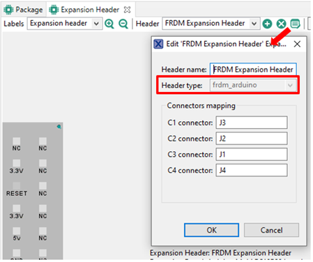

  1. Get the type of expansion header in the FRDM-K64F board.antonintomanec_19-1630309130896.png
Figure 3 Edit expansion header dialog
  1. Edit the header_connection in the expansion board XML.

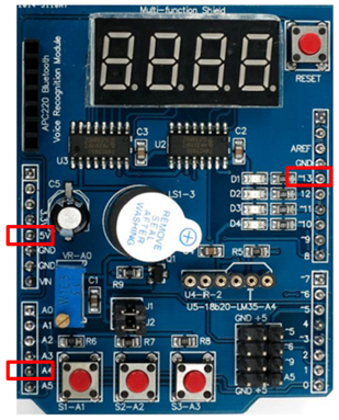

The tutorial describes how to add a pin element within the connector elements in three examples. See the marked pins on the shield below.
Figure 4 Arduino Multi-Function shield

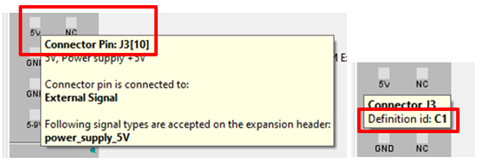

  • Find the board pin in the expansion header view. The pin tooltip shows connector J3 pin 10. The connector tooltip shows the definition id for J3, which is C1.antonintomanec_20-1630309515294.png
Figure 5 Connector pin and connector tooltips in the Expansion header view
  • Pin 5V is an external pin from the processor point of view (not connected to the processor). In the common_signal_types.xml, find a suitable signal type.antonintomanec_21-1630309578613.png
  1. Add the element pin with reference 10, name on the shield 5V, signal type power_supply_5V, and the description in the connector C1.

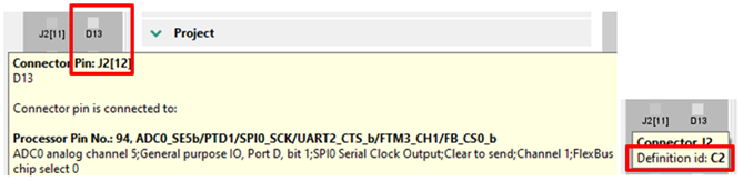

Pin 13 (LED - D1)
  1. Get the needed pin element attributes values
  • Find the board pin in the expansion header view. The pin tooltip shows connector J2 pin 12. The connector tooltip shows the definition id for J2, which is C2.antonintomanec_22-1630309813636.png
Figure 6 Connector pin and connector tooltips in the Expansion header view

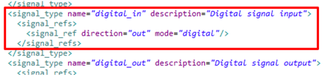

  • Pin 13 is connected to LED D1 on the shield. It is digital input from the shield point of view, it is output from the processor point of view. In the common_signal_types.xml, find a suitable signal type.
  1. Add the element pin with reference 12, name on the shield 13, signal type digital_in, and the description in the connector C2.

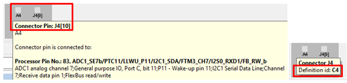

  • Find the board pin in the expansion header view. The pin tooltip shows connector J4 pin 10. The connector tooltip shows the definition id for J4, which is C4.antonintomanec_26-1630310445013.png
    Figure 7 Connector pin and connector tooltips in the Expansion header view

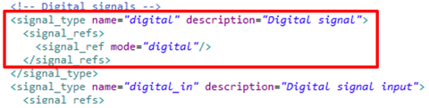

  • Pin A4 is connected to DS18B20 DQ pin which is Data Input/Output. In the common_signal_types.xml, find a suitable signal type.antonintomanec_2-1630311946370.png
  1. Add the element pin with reference 10, name on the shield A4, signal type digital, and the description in the connector C4.
