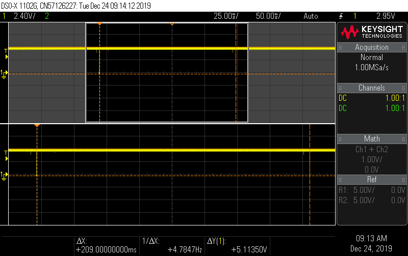

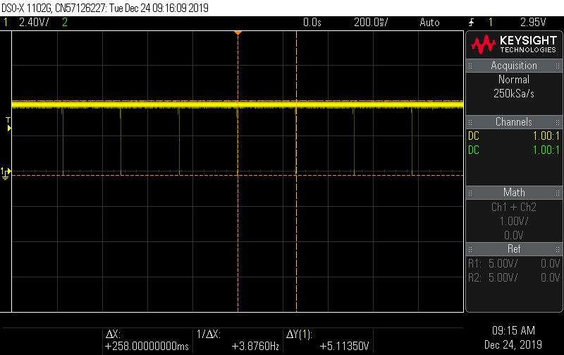

We're using a KE1xF with ROM bootloader. Testing the Bootloader timeout we have noticed that the bootloader spends 208ms regardless of timeout value. To check this behaviour we did a simple app that at boot resets device with different bootloader timeout, and capture reset signal with oscilloscope.
In the first image the bootloader timeout is 50ms and the second is 1ms. So you can see a delay between reset of 258ms in first example, and 209ms (see cursors) With these examples, we don't understand the extra 208ms that bootloader spends doing anything.
If we want only 10 or 50 ms in bootloader, what is the solution?
Thanks for your support
Jan

We guess that there is a possible issue on the enabledPeripherals field. When we set that field to 0xFF (default value) the timeout meets with set value, but when we set only the CANbus peripheral (0xE8) the timeout adds 208ms extra to the set value.
We don't know what is happening, maybe the initialisation of peripheral adds this delay... but 200ms seems too much.
It is possible to avoid that extra timeout value?

Yes, it sounds strange but I also see it. When I disable LPI2C, this 200ms delay appears. It seems you have to enable LPI2C whether or not to use it.
Jing

jingpan
I've investigated this problem. It is a ROM bootloader bug. I've reported it. But there seems no way to get around.
